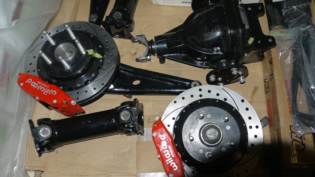

all my parts form the states have finally come, has taken nearly 6 months!, here's pics for those of you that are interested
Tremec T56 magnum 6 speed box
wilwood 13 rotor, wilwood 4 pot caliper, tubular trailing arms
Front wilwood 13 rotor and 6 pot calipers
QA1 rear adjustable shocks
new 12 bolt diff converted, stronger halfshafts, vbp 360 composite spring, the complete drivetrain can handle well over a 1000bhp

alloy wheel and 13 inch rotor, could have gone for the 14 inch rotor, just about enough room there, next time!
close up of half shafts, they are lots bigger than old ones

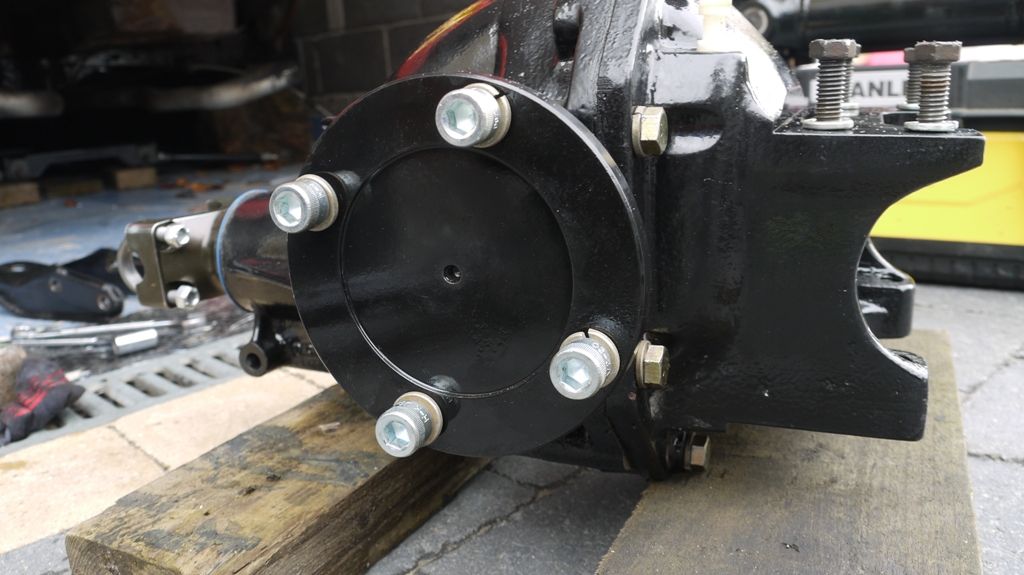

diff yokes
comparison between old and new rotors
