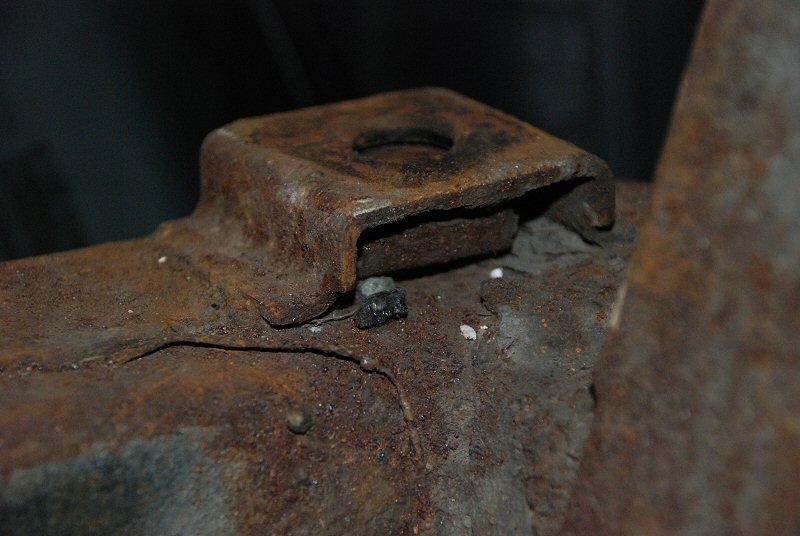

First job after removing wheels and sitting on axle stands was to remove the body mount bolts, so starting at the no.3 mounts, access covers were removed easily as there isn't much underseal on the car. the bolts were in good condition, but as i was to find all over the car, that didn't mean it would be easy to remove them. the left finally came out okay, but the right only unscrewed half way, then it seems the nut in the cage on the chassis has come loose, so bolt and nut now spin freely - great. I am now decidint how to deal with this, but expect to cut the bolt in some way if possible, would a reciprocating saw do the job, is there enough access any experts????
The same problem happened on the left no. 4 bolt, so i removed the rear speaker etc only to find that i have illegally imported a north american mouse!!! curled up and very dead, infact quite crispy. should i own up to the immigration authorities??? Laughing Laughing So eventually with the nut contained, i was able to unscrew the bolt - easy really. the bushing seemed in reasonable condition.
not so easy on the right side no. 4, eventually my unpaid labourer Ben managed to pull hard enought to shear the bolt.
After a good look around underneath, it appears that virtually every expsed bolt head is very rusty and will all be seized solid aswell, just to make the project easier. but at least it has vilified my decision to do the job....

cheers, i've managed to curb my habit and not visit Halfords at all today - decided to go cold turkey. Well, now i've had a real go at the car as i said to you, thats it til the end of feb, must do some studying etc, but it'll always be sitting there alone in the garage when i am sick of studying, so watch this space. out of interest, did you remove you're rear spoiler before your bumper, or vice verca, and that rocker panel scre wis still giving me the runa round, any thoughts other than my heath robinson drill approach?

My spoiler has bolts through the rear deck and through the rear bumper so there's no way the bumper would come off with the spoiler in place.
I've just been out to take a picture of the no.3 body mount position on the chassis.
The cage that contains the nut comprises two parts: the main (visible) box; and an inner box that you can see peeping out in the picture below, like a bashfully-rusty, square-shaped lobster under some equally angular rust-coloured coral. I'm not sure why there are two. It's conceivable the nut could be turning within the inner box, I suppose. I'm pretty sure (having looked under your car yesterday as the bolt span freely) that there's no way of getting to the nut or the lower threads of the bolt from below. Any attack you launch on the bolt will have to be to the head of it through the wheelarch access hole.
