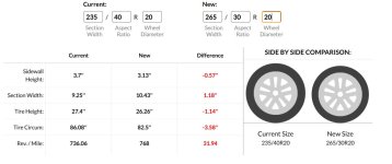

Use the Differences in the compare of tires sizes below
You will have to determine, best is after new wheels/tires installed is go for a drive with a GPS that shows
MPH and compare that then with what the speedo shows and if not matching is needing to replace the gear at end of speedo
cable and/or the one in the tranny to get the speedo to report correctly
Looking at the rev/mile difference would give an idea if speedo would be off and by how much

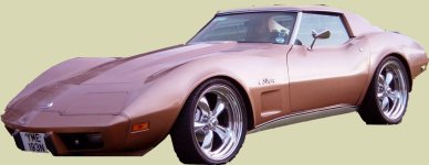

Hi guys I’m here lol
I’ll have to check as I’m sure on my 75 I have 8.5” wide and my 66 has 8” wide, for the life of me I can’t recall the tyre sizes but will check later, they do 2 different offsets depending on whether you plan on lowering it, I went with them slightly In so I could lower my car, if you call North Hants Tyres in aldershot and speak to James he will have alll the info you need as they supplied both of mine and tyres 0D7A7A41-1561-496F-B638-545FECBE4317.jpeg8C5FC5C4-4346-4262-ABFE-6CE5423508F8.jpeg
Budgie
I’ll have to check as I’m sure on my 75 I have 8.5” wide and my 66 has 8” wide, for the life of me I can’t recall the tyre sizes but will check later, they do 2 different offsets depending on whether you plan on lowering it, I went with them slightly In so I could lower my car, if you call North Hants Tyres in aldershot and speak to James he will have alll the info you need as they supplied both of mine and tyres View attachment 17040View attachment 17041
Lovely looking and colour c3,,and that size wheel really sets it off,,got me thinking,lol,this my c3 with 15s
