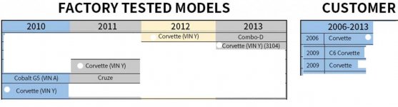

FYI, the Amazon URL you point to is an older model, you did not mention what year your Corvette is
what you bought shows ONLY tested 2010-2013 Model years and not sure if it supports both American and Europe frequency
If you look at the American Amazon website, shows that same model but newer version up to 2022 MY
Newer model
