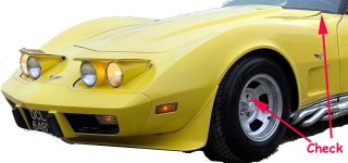

I do remember him saying that it has been removed for the uprated exhaust on the phone, but will ask about it when I get down, here is the link if anyone wants a look ! :)

Some of those hoods would have been like that when they were new. Fit/finish was not a priority in those days. Chevrolet could sell all they could make. Get them out the door, onto the showroom floor.

That sales page says engine was replaced back in 2002 with a racer type engine, looks like high raise intake manifold
Pulley off water pump shows a slot for an A/C compressor belt, but see no brackets for it
See no A/C dryer, or Freon lines
Coolant fan was replaced with 2 electric ones
Needs a wiring cleanup.
No power steering ?
Myself do not like how that left fender and/or hood is out of wack or warped corner
Looks like it was a racer, so I'd be sure engine. tranny, etc is in good working order
Someone needs to decode that VIN #
