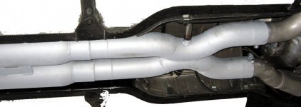

I spend many months in testing different designs and metal types as how sound can change as to design.
Including if a stock H pipe in mid-pipe to my final design of using 3 inch X-pipe in place of the CATs
Team ZR-1 Exhaust Design & Testing
Final outcome of exhaust sound changes depending on using mid steel pipe to stainless steel
Size of pipe from exhaust ports, where the H or X pipe is installed to position of exit tips and direction they are pointed

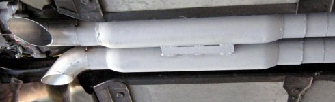

As photo, I showed above when tips were placed by the tranny and pointed downward, HOLD your ears as in my case using 3 inch pipe from the 3-inch header collectors to even the inlet and outlet of mufflers also 3 inches and the sound bounced off the ground, then back up and bounced off underside of the Corvette
I used a dBa sound meter for all testing and even found that if sticking the tips straight back and placing them past ass end helped lower the dBa from 112 when tips were under tranny to 84 dBa (inside cabin) when tips ended further out
Even a difference if I used a single or double wall exhaust tips and if I used 3 inches or 4 inch tips
If wanting to balance the sound, add a H pipe mid-stream
Want better skavaging and exhaust pulses use an X-pipe close to exhaust manifold or collector of headers
