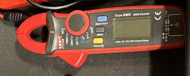

Wow thanks for that info JR - that's amazing - really comprehensive! I didnt realise such a thing as an inductive amp clamp existed, so I have bought one of these as I think it will be really usefful! (I always used a multimeter and held the probes to the battery / negatvie terminal before).
I will have a go at running all those test next weekend - thanks again!

I recommend this mini clamp multimeter UNI-T UT210E costing less then 40 pounds from ebay .
It is quit accurate and I have used many times :)
