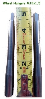

Thanks. Saw those but they are only 13cm long. Given the rear wheels on a GS or Z06 are 335, ACS make pins that are 20cm long. Really need long pins for wide wheels.
These are the ones I use for my C5 with 10 inch wide fronts and 12 inch rears
130 mm long, (5 inch long)
They only have 2 left, looks like in Canada ? $27 Each
These
Look like This 3-piece set of 200mm (7.87-inch) long hangers
3-piece set $80
You need to check if the C7 also uses as C5 of M12x1.5

If I was to buy these again, I would go with the 8-inch ones due to my 12-inch wide rear wheels
The 5-inch ones I have are fine with the fronts of 10-inch wide but for rears and how heavy they are
would be better if the wheel was a bit further outward to line the stud bolts to the hangers
If you're making these, you need to assure the threaded end is not larger than the size of the holes of the rims

Yes. Plenty of those around on the market, and with different threads. All short again.
One thought is not too make them too long as it becomes like when reason in needing a breaker bar
As heavy as the tires/wheels like I use, the further out the hanger is, the more downward force is on
the threads for only the 2 hangers installed on hub
Cannot recall but think my rears are like 70 pounds each
