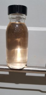

I drew some out yesterday and it's completely clear with a slight pink tinge. Esso Supreme is 1% ethanol at most but previous owner may have used who knows what?
