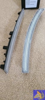

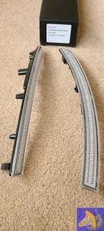

Ian, Three club members in Notts with UK spec/Ian Allan supplied C7s have done this. The existing (UK/Euro) markers are just reflectors, so they bought new side marker lights, Good news is the powered connectors are in the car, so just need connecting to the new marker lights.
One of them (white car) bought the GM/Original Equipment US spec (2 bulb) ones at circa £150-£200. The other two bought Chinese (circa £50) multi LED bulb ones that are smoke black when the lights are off (see video). These are much brighter when illuminated (blue car), but the lads are telling me they can/do give fault codes on the Body Control Module (BCM) including TPMS error codes. So maybe best avoided?
