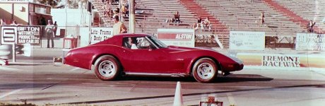

Hi all just a steer really as putting a new exhaust system on the C3 early next year and torn between standard front to back Stainless or side pipes….. Side pipes can look and sound nice but hearing some not so good feedback so I thought I’d run it by you all for advice / views.
Cheers.
