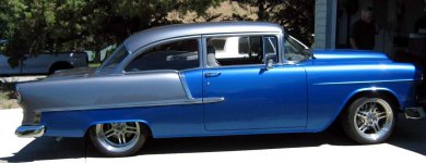

Here's my other LS (vortec) powered car - a 1953 Chevy Bel Air. It was modified in the US in Carlsbad and had a complete turnkey engine supply 375hp LQ4 crate motor fitted. This really runs good, but it has an MEFI-4 pcm fitted with I believe a locked tune. Whilst it runs very well as it was set up by Turnkey when it was fitted, the mpg isn't great and if it expires I'll go for something tuneable in the UK. It seems a very basic system being speed density with no O2 sensors, so a decent system would see an improvement I'm sure. It's more a cruiser rather than a racer, but it is pretty sharp for what it is. It has a TCI front clip with power steering, 700R box and Ford explorer rear axle.

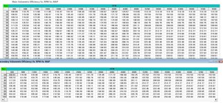

If PCM is not locked and tuneable
What is needed to be changed to correct the AFR is the predicted air mass values of Volumetric Efficiency tables be changed and the fuel injectors pulse width ON times as changes in elevation and weather changes

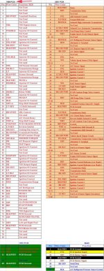

The stock GM PCM has 2 80 pin connectors, one is labeled red, and the other is blue
GM part number ends with 0411, so from that you could tell if really a stock one or not
This PCM design was used in many GM vehicles from 1997 to 2004 timeframe, so easy to find used ones for sale

97-98 F & Y body has as early design of the 99-04 0411 PCM
there was a period when GM moved from the 94-95 design, but those also can be tuned
As you mention, and I have done is move the wiring to PCM from the early models to later ones

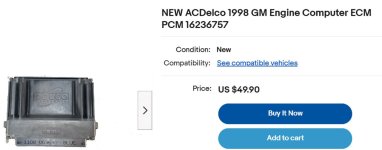

97/98 Camaro PCMs still sell like on Ebay as low as $50 as shown below, and the calibration is about the same as 1999 MY as shown below
