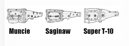

Shift side cover is easy way to tell. It’s on the drivers side. If it is a Muncie then there’s a cast number in the passenger side which along with the stamped number will tell you what was originally inside as well as if it’s original to the car.

Won’t say Muncie. Side cover will have two shifters and 7 bolts round the edge if it’s a Muncie. B39B3151-DBA3-42F3-BB11-0B4B0C3C658A.jpeg
