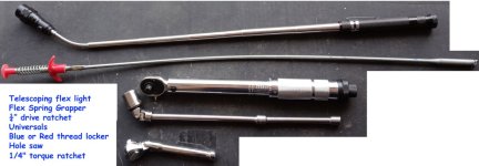

Just thinking out loud for tools needed to install bolt
Could use tape to temp hold bolt in socket so not falling off and down bellhousing
