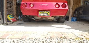

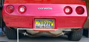

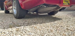

I'm slowly getting through the jobs on my newly acquired C3 and probably the most pressing is the bottoming out when hitting a depression or pothole at speed.
Having fixed the cat converter hangers which had perished the exhaust now hangs a little higher than it did. However, the back roads around me are bumpy as hell and the car is bottoming out with the cat and the bottom of the pipes making contact with the tarmac. All of the dampers look to have been replaced recently and this would likely affect bouncing rather than initial travel?
The rear suspension does seem soft but I don't know if it's supposed to be like that or whether my rear spring has gone.
It's sporting what I assume to be the original fiberglass spring. Do these deteriorate over time? How can I tell if it requires replacement other than changing it and seeing what if any change there is?
Alternatively perhaps my exhaust system is just too low? I've attached photos showing the rather terrible clearance. Is this all due to having to accommodate the catalytic converter? Anyone else running a late model C3 with stock cat having these issues?
