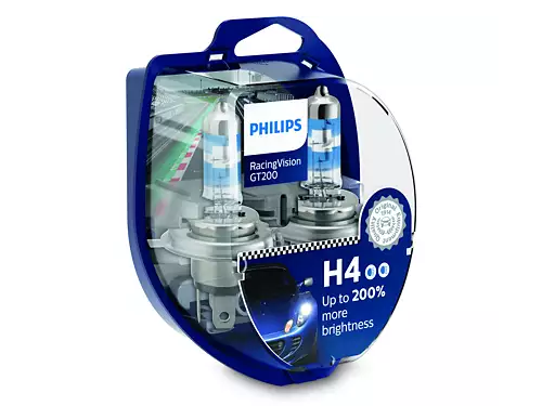

97BlackC5
Just ordered a set of.........
H4 Philips RacingVision GT200 12V 60/55W Halogen Bulbs (Pair)​
Thanks for the info BobbyV8, they arrive Friday so if its dry at the weekend I have got myself a little job to do.
