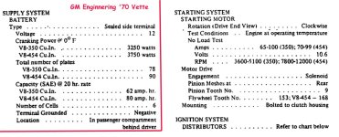

GM battery Specs for 1970 Corvette
Refer to the engine size as battery rating different
3750 watts cranking = 312.5 amps
