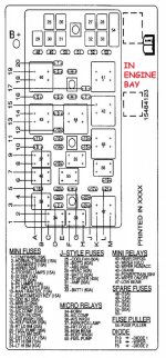

8. Now go to the fuse panel in engine bay, there is a positive connection from battery, at corner outside of fuse panel
Measure voltage from that point and ground, what is that voltage reading ? Check ground right below that as clean/tight

12. Check main fuses for the PCM, BCM, IPC (dash) controllers, they will not work if voltage is less than 12.5 Vdc
13. May have to check voltages and ground at starter
Remember the BCM (Body Chassis Module) is the boss, as all controllers connect to the CAN/GMLAN networks and talk to
each other via BCM, so if it is not getting power or ground then all controllers are deaf and cannot function and share information
Engine bay Fuse panel
BCM, Fuse Panel, Relays. On-board CAN/GMLAN Networks

Also, when door is open, does the security light in dash flash, as if hard on that would say the BCM is not talking to the PCM so for security would prevent starting engine
Follow this drawing I attached here starting with the fuse I point to and then follow the grounds, brake and park switches
Also need to assure the fuse for the BCM is not blown
Might be easier if you print this photo, so it fills the printer paper to see better as this is all that is involved for starting
Look at the 2 fuses and the arrows I point to
