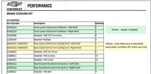

So I have a UK C8 Z51, and am planning an alpine road trip and am thinking of getting the brake fluid changed in advance. When looking into this, I also know we have the Z51 brake cooling kit, which I have in a bag that came with the car. Looking at US forums, some people are saying dealers should have installed all of the elements apart from the rear lower control arm cooling ducts at PDI (as these are track only). Should Ian Allan have installed these, but didn't? I'm considering adding them on, given I paid for them, so might as well get some use out of it! Any experiences or definitive guidance would be appreciated. The new UK dealers don't seem to have an answer for me.
Also, if anyone knows if the C8 has a flat beam that doesn't require beam deflectors for driving in Europe, let me know. I'm currently assuming it does, as a modern LED setup that is sold in RHD countries - but again, it doesn't seem straightforward getting this info.
Dealer should have installed those if customer wanted them on

GM
Brake Cooling Ducts
Z51 models include brake cooling parts.
Install the brake cooling deflectors (Fig. 27), except the rear lower control arm brake cooling ducts.
Fig. 27
The rear brake cooling ducts (Fig. 28) that attach to the lower control arms are for track use only and should not be installed during the PDI. Driving the vehicle on the street with the ducts installed may lead to part damage from road debris or poor road conditions.
Fig. 28
Termie
Hi Termie, Not having a C8 I don't know. What are the items apart from the cooling ducts? Might be worth enquiring on the C8 Corvette UK Facebook page where C8 track days have been organised/discussed. Or maybe Stuart C. with his new C8 knows the answer? And yes, the headlights are flat beam I think. They can confirm that on the Facebook page too.
Thanks. Teamzr1 has helpfully posted the parts above. I was thinking of adding the top elements front and rear. It is predominantly for street driving, albeit perhaps some fast/heavy braking in a road tour (and the car is also fairly heavy). I'm trying to weigh up the pros and cons. It only came up because I was looking into brake fluid/brake cooling, and then tugged the thread on these parts and saw some dealers are installing the top parts as part of PDI, at least in the US, so it got me wondering. On one hand, I'm not tracking the car really, on the other hand, cool brakes aren't a bad thing and these are OEM Z51 parts that Chevrolet provide... 🤔

I appreciate you asking. There appears to be PDI sheets that say for Z51 equipped cars, parts of the kit should be installed. See below (first "Exterior" bullet). Apparently some dealers are doing it right, some aren't :cautious:
Chevrolet
Confusing? Looks like you are right?
