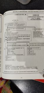

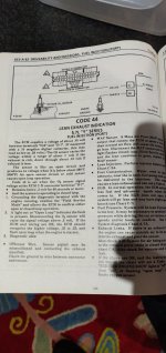

Steven Smith
Picture attached of fault 44 from the shop manual, this is for a 86 but should be the same.
With engine warmed up and ECM has gone into "Closed Loop" if not having an OBD-I scanner
Then using a good D/C meter
O2 sensors used are "Narrow Band" that function from 0 to 1 Volt (1,000 mVolt)
At idle, output of O2 sensor should be around 0.500 mVolt,
The higher the value reads above that, the richer the AFR is,
Lower values equals, leaner it is
So if the DTC trips says O2 reporting lean values, then should read values below 0.500 mVolts
