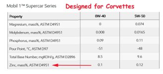

Not sure what version of Mobil 1 you're mentioning, but I have my 99 C5 used oil tested by Blackstone Testlabs and always show correct amount of zinc in test results
Also shows even with the newest supercar version for Corvettes having zinc
