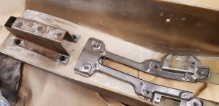

Handbrake console bent

The plastic console is reinforced inside with a screwed on metal frame.......
Drivers often put their hands on the console for support when getting into or leaving the car and this can eventually cause the frame to brake free from its attachments, often resulting in the sort of distortion you're seeing. New consoles are available but the damage can usually be repaired by bonding the metalwork back into the console. A high strength adhesive is essential and I think I used an Araldite of some sort when repairing mine.

To be fair, it does look like that's what's happened, as the screws you can see at the top here are not screwed into anything.

The handbrake console is certainly a weak spot on C3's......and yes I have heard disconcerting crunching noises many year ago when, perhaps foolishly kneeling or leaning on it when getting in the car. I do have a new replacement.....but won't fit it untill I have (and hidden from view) added some 'glassed-in' strengthening on the underside.

It's an after market one missing the reinforcement, I bet the rear one is missing also, by fitting it ,it will return to a better shape
A '71 I had a while back had a slight crack in the cover from as mentioned resting on it getting in or out. I fixed it and reinforced the underside with new glass. Well worth doing and makes it much more resilient
