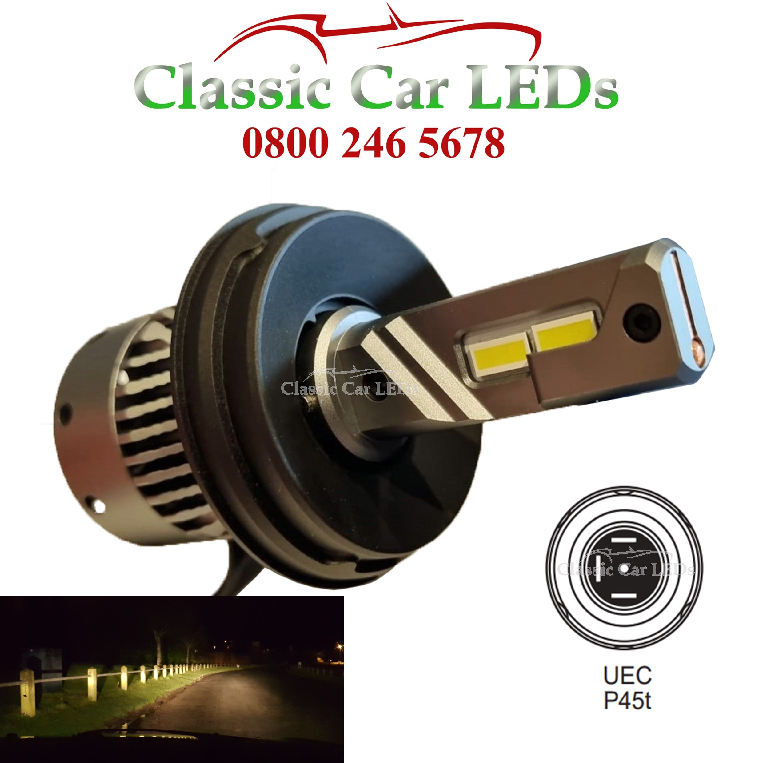

I use LED bulbs in my headlamps - H4 bulbs with H4 5 3/4 inch headlamp reflector (in my dipped beam only - my main beam is currently standard). Note that only cars built before a certain year are allowed to be retrofitted with LED bulbs. All C3s are fine.
E.g.:
Various H4 bulbs here (I picked LED bulbs with the "LED box bit" built into the bulb so it wouldn't snag on the popup headlights):
H4 headlight reflector with PILOT light hole, used for my dip beams with the side light bulb in (I didn't need these as my dipped beams had already been converted to H4 bulbs during import):
H4 headlamp reflectors (no pilot hole if your sidelight is elsewhere):
LED sidelight bulbs for the pilot hole:
All the LEDs have a colour option of modern white light, or classic yellow light. I went for modern white light. Not driven much in the dark with them yet, but they seem good so far and much less power draw too.
