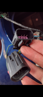

Maybe an issue with the loom behind the headlights. If you take the right rear one out you'll find the big connector from the body wiring harness. Mine had badly corroded and I changed the plug on it. It's a Delphi GT150 here, easily available. Check that connector first and go from there
