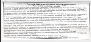

A couple of years ago i had the dreaded steering lock issue and bought a lcm5.i have a 2000 c5 which i bought new ,low miles so reading up fitted the lcm5.All ok with no more issues but every time i use the car WAIT 10SECONDS PULL KEY comes up .This is really starting to annoy me ,can any members suggest a fix many thanks

oelarse
Have you done the brown wire modification ?
On my 2000 car I had to do this modification to get rid of this message :)

thankyou for that ,i dont think i had this paperwork with the lmc5 or maybe i did but thanks anyway will try when the appetite takes me
