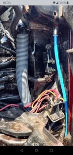

My ECU saga continues, looked like the program issue has been resolved, but when the guy tried to start the car last night, ignition on, then all electrical power lost. Battery test is good, under bonnet fuses all ok, on another US forum someone talked about a fusible link, but unhelpfully no mention of where this is located, anybody know? Or anyone have any other thoughts on what may have caused this loss of all electrical power?

Thanks Corvetteville, I have passed this on to the guy working on the car, jeez I really hope this is the problem which should be easy to fix!

As others have said fusiable links are on the "jump start post" behind the battery.
Make sure they are all clean and not corroded, the windscreen drain and the bonnet lock drain are both above it so it is prone to get wet and cause issues.
