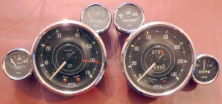

A few years ago Adrian Sidwell overhauled all the instruments from my Daimler SP250.....P1050806.JPG
......including the odometer - and did a first-class job. He's not restricted to British cars and will happily overhaul and repair American instruments as well.
His charges at the time were very reasonable. Might be worth giving him a ring?
Seeing those, I would really before buying the whole gauge is taking it out and make sure the trip and odometer numbers turn easy
Indeed, things do stop working because they just get bunged up with dirt, dust etc.
