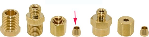

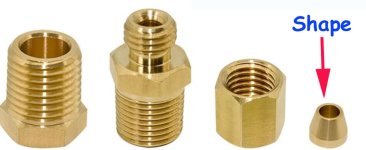

There is a fitting that goes over the end of the copper tube
When nut is tightened, causes fitting to compress and prevent tube to pulling backwards and prevent leaking
