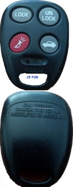

As to your FOB
It depends on if the C5 you have was to USA specs or not
The difference is the US FOB and VATS security frequency used is different,
so a replacement US FOB would not work if the C5 was for outside the USA
So you need to first find out which frequency your FOB sends out and then buying spare ones are cheap, places like Amazon have them

The FOBs have their own wireless controller and talks to the BCM as to locking or unlocking the doors and hatch
so FOBS still work when turning VATS off in the PCM
433.92Mhz is the Euro spec frequency, which is stamped on the back of the FOB. Japan also uses the Europe 433.92 Mhz
so if that is where your C5 came from, I'd slant that is the Europe FOB model
USA domestic version is 315MHz.
You need to find which yours is before buying others
Being as you see the back of my American FOB it lists the model number
Yours does not, so either that is the Europe one or some 3rd party one that did not list its model number
Does the front of your FOB look like mine ?
Maybe if you take the back off where the battery is, there is listing which it is ?
One of my FOBs for 1999 C5
Here are 2 other places that sell the blank keys once you measure the pellet to know which one
Also
As you can see, your FOB design has fewer functions as to buttons and switch as stock GM ones
Also, the FOBs starting in 2001 MY are different from 1997 to 2000 ones
My 1999 C5
Yours
So I still think your FOB is the Japan version at the 433 Mhz model

It is also possible to veryify the FOB freq. using an Autel TPMS tool .
I used my Autel to verify my second FOB that was not working .After cleaning contacts on the circuit board I checked using my Autel like this and it displayed the frequenz like this.A tyreshop should verify this in few seconds :)
