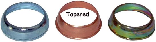

If the sparkplug holes are not tapered then using index washers that are made to be crushed when torquing the plug
BUT if the hole is tapered, then user a taper type of index washer like these :
Need beforehand, a torque wrench you know is calibrated
