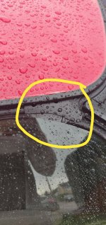

After months of trying to track it down I think I have finally found it.
Whenever it rains heavily I get a puddle in the passenger footwell, it appears to be getting in where the roof panel sits on the window. After renewing all the weatherstripping it was still leaking.
After putting a piece of plastic over the two seals it has stopped, it was getting in where the two seals meet, running down the inside of the windscreen trim, behind the fuse area and into the footwell.
I shall be out with the hosepipe tomorrow to test my theory.
