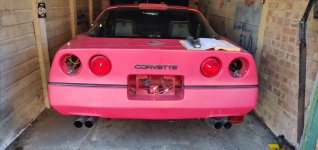

Has anyone found a replacement for the factory fitted space saver spare tyre ?
Dropped my one out yesterday and it appears original, nearly 40 years old and perished.
Size is T155/80D16 can't find this size listed anywhere, is it just a case of measuring it and getting the closest match ?
While I have all the rear lights out of the car I would like to renew all the corroded fixings, is there a UK source ?

I had same thing on my 78, original & shot! Took it & the car to my local friendly tyre place. They found a tyre with same rolling diameter & width. They said it was a van tyre, but does the job & fits in the under tray.
