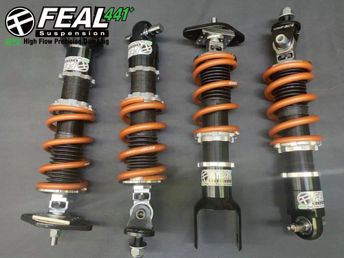

You will need to decide what rate of springs you want for the front and rears that suit race type and your drive style
Here are some examples :

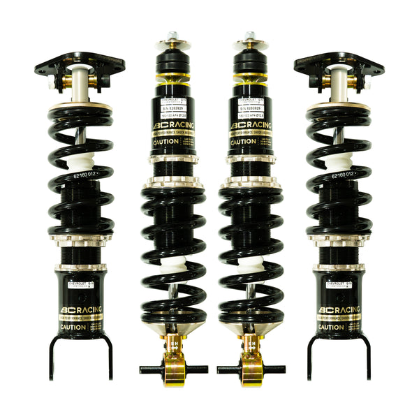

Contact AST/MOTON suspension UK they offer a three way coil over system for the C6. Click on the link below for more info.
Hi
Sorry no as I do not sell products
If you go to that vendor I posted above, they are in Florida and see if they can ship to you
or maybe someone here who also visits that state could get what you order and bring back to the UK ?

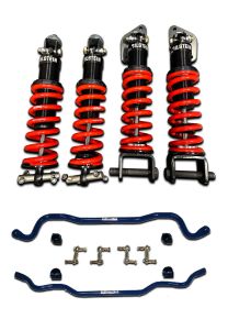

I fitted LG Motorsports coilers to my C5 plus the GM T1 Swaybars made the car handle like a go kart :)
The kit linked below includes LG motorsports swaybars as well as the shocks.
They do other kits with just the coilovers. You might also want to consider doing the suspension bushes at a future point. I upgraded all of mine to polyurethane ones.
