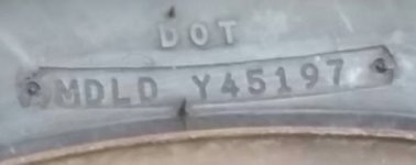

Having not found a date code on the outside walls of my Goodyear tyres i just crawled under the back of my car and found this code on an inner tyre wall...
DOT - MJUT250487
Am i decoding this correctly?... Plant MJ / Size UT / Manufacturers code 250 / 48th week of a year ending in 7 in an unspecified decade (dumb!).
If that is correct then the 3 digit date code indicates its before the year 2000.. the year could therefore be either 1987 or 1997.. either way, not good!!
Please tell me ive got this all wrong and that they were new last year... or just tell me the truth if you really must.
Pre 2000 the last three digits of the DOT code represent the production week and year, the first two being the week and the last the year. So your 487 would show manufacture in the 48th week of 1987 or 1997 as you surmise.
Post 2000 the last four digits represent the production week and year, the first two being the week and the last two the year. If your tire was post 2000 the week would be 04 and the year 2087. Since we haven't yet reached 2087, I think your decoding is correct.

How completely stupid it is that before 2000 they didnt specify the decade!
I really dont give a $#*+ which week you made them in.. tell me the frigging year Goodyear, you bunch of @#*%'s
I mean, they could even be 1977 but being a 1981 car lets hope not.
