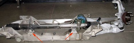

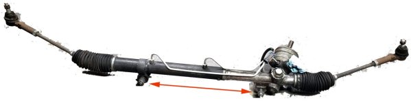

Sounds like someone worked on the front end and did not torque down the rack's mounting bolts
No, there should be no movement of the rack
Should be simple if you jack the front up and be easy to see those bolts and torque them down in proper placement
Also, I have never heard of a C5 rack emitting sounds
Make sure you check that the mounting bushings are good

Your lucky then as if the right side also got loose and going into a turn and the rack slide to one side
Good to hear you got that fixed but if loose again I would use like a blue thread locker on the threads of bolts
