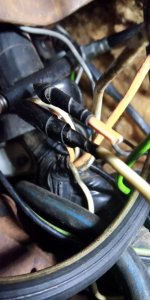

Trying to understand the workings of my car. Looks scary and as not mechanical/ electrical trained can someone help with this. Picture attached. Located on drivers side outside panel.

What year and model ? My first guess is a rather ancient type of electrical capacitor . Not come across anything looking like that like that in donkey`s years .

😆 Yes it looks like the dynamite has exploded. The dash lights don't work but I think it looks like the driver side foot well light has been sniped off - could this mean the circuit has broken so no cabin lights work? Just a guess.
Would need to see more of that area to see where these wires go to
Maybe some alarm system ? But abandoned as wires cut
Need a photo that is showing more of that area

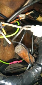

The capacity is cable tied up and not functional. Possibly alarm but should the driver side have an lighting in the footwell?IMG_20240204_144018_9.jpg

Yes, that's an old-fashioned type of capacitor, often called condenser. It's cylindrical and probably waxy* because it's made out of strips of paper and metal foil that have been coiled together. The foil is "plates" that hold electrical charge, paper is the insulator between them and wax was used to stick it all together.
Capacitor has two possible functions,
1. Radio interference suppression, by suppressing certain frequencies. Suppression of interference is most difficult in cars with glass-fibre bodies which, unlike a steel body, have no screening effect.
2. Preventing momentary voltage drop to the attached component while the car is being cranked.
My bet is on 1. above in the particular application.

It acts as a suppressor for the radio, there is 1 for the indicator flasher unit, 1 for the brake light, 1 for the hazzard flasher until, there is 1 for the distributor, not generally needed if a modern day radio has been fitted as they tend to have built in.

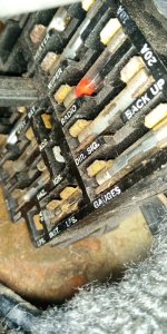

At least from the angle of your fuse panel photo, check the radio fuse as it looks blown
