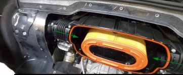

Living in the warmth of London I wanted a ‘cold only’ cowl induction system so made my own. The factory version takes hot engine bay air and only includes cold air at WOT. I have incorporated the ‘triangle of death’ into it for good air flow. The solenoid WOT operated cowl induction flap is removed and therefore open all the time.

Cooler air into the intake will also be a better charge to the cylinders and better the AFR for WOT
While the venting of hood reduces front end lift and keeping the overall engine bay air temps cooler
to reduce heat long term on everything in the engine bay

Under bonnet pressure/heat has to escape via wing side vents and bottom of the engine bay as it can’t vent at sealed cowl opening.
Temperature reduction at intake is typically about 15 deg C less than engine bay, so worth several BHP.
