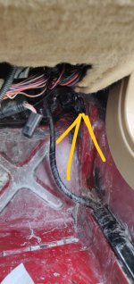

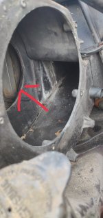

Steven Smith
If you look under the passenger footwell, remove the plastic panel with the light in and there is a blend door right up in the top right hand corner.
It's a pig to get too.
