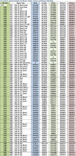

C3 Corvette Casting Numbers for Blocks, Heads, Intakes & Exhaust Manifolds
Based upon that info, my (late) 1968 327 300hp uses the same block and stuff as the 350hp variant. Now just to find the other 350hp bits and swap em over.....
Many people 'building-up' a 350 now go straight to an aftermarket 383 stroker rotating assembly......you may be able to do the same (hopefully?)
I've noticed that same block casting number is used for both lopo and hipo versions of SBC and BBC, even L88 on earlier years. Does that mean 2 bolt and 4 bolt blocks are the same (except perhaps for differing crankshaft support caps and tapped holes in engine block?)
I remade my Excel chart above so easier to read or print out
still though this forum software is reducing the size of what the image really is :(
