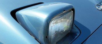

I won't repeat what can be seen on the video but here are a few pictures that show how it turned out on my '92.
The inside of each motor gearbox had the tell-tale powder of the disintegrated gear although the main gears that engage with the worm drive on the motors were both in good condition.
Once cleaned three 11mm lengths of the Delrin rod were cut off for each pod. They are supposed to be 7/16" but I could only get 12mm which is a tad too big (7/16" = 11.1mm) so they had to be gently sanded down to the right diameter before everything would fit nicely.
Careful remembering where all the factory shims went, reassembly was pretty straightforward. I used silicone grease to pack the new gear set. The most difficult thing to do seemed to be to get the electrical headlamp connector to fit back on its mount in the side of the front wing - it took ages, I was probably doing something wrong. The time to do both pods was about 4 hours.
The headlamps (fitted with LED H4 bulbs) seem to work ok but I will take the car out late one evening this week to see how they are at night. They will probably need some alignment but I can't believe that they will be any worse than they were before.
Quite pleased with the result: the clack-clack has gone and they index round noiselessly. These should now be UK legal - they are E-marked and hopefully should be good deal brighter than the originals.

Is it just the angle of photo or does the head unit need adjusting a bit as gaps in front corners showing ?
I did each pod separately and put the first one back to the mimic the other so they are both the same. When closes the positioning and dit is really good but I must admit I was a little disappointed that when open the look like they don't fit so well. Would you have a picture of what a good set up looks like? Should the base of the pod line up with the bodywork when open?
TimP
This looks a bit better.... although looking from this angle I think there is still a little adjustment required to make the bottom gap parallel. So much easier to adjust these than the C3 pods - clearly the GM engineers learned to do things a little simpler in the later generation.
Need a clean as well.... Thanks for the help/advice.(y)
