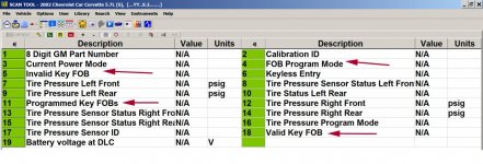

FOBS, VATS and TPMS all remotely function through the same controller and has an antenna at all 4 corners
So if others are working good sign the controller is OK
Could be a ground issue, controller is located if a coupe on B pillar on drivers side by hatch
Also,
Use a OBD-II scanner that can connect to the RCDLR (controller) and doing so can see exactly what the controller
sees as to the FOBS and would show this controller is functional or not
In this case I show the PIDS (Parameters) RCDLR sees of a 2002 C5

Since antenna 1 is to work the longest distance I would use that one (driver side) and try to get setup done
As mentioned if getting to a OBD-II scanner you could watch it live as you worked with FOBs and see if they and the controller
works correctly
The controller could be confused between FOB 1 and 2 so may need to reset them and then work with just driver 1 setting till it works
before doing FOB 2 as driver 2
IF all 4 TPMS report correctly on the DIC and VATS is working that tells you RCDCR is functioning remotely
