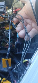

So my stereo is a Pioneer Carrozzeria AVIC-ZH9000 and as an extra, you can purchase 4 black wired metal antenna's to help with the Japanese GPS system (pictured below, now discontinued)
Would we agree these wires look VERY familiar with the plugs in the back of the stereo?
I know I have windscreen antenna's (but will have to check how many in the morning and hope I see 4) and it would explain why they group together and head behind the dashboard

I've just gone out and checked, I do have 4 antenna's on the windscreen, each with the same gauge black wiring coming from them. So happy to say that is to do with them πŸ‘ worry over.
Now I can concentrate on the 16 wires that go in to the Pioneer plug.

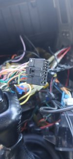

The new stereo I've bought has 2x 8 wire plugs (male) as shown below
and they fit in to here
If you could send me the wiring guide, that would be a HUGE help β™₯️

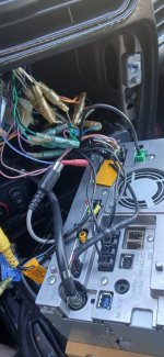

A lot of the labels aren't there.

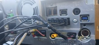

I'm definitely on to a winner I think... the Carrozzeria wires that are connected to my current unit are as follows:
Main Antenna (disconnected and ready to fit in new stereo).
GPS wire (no longer needed in new stereo).
AV INβ€’OUT (not connected to anything and not needed anyway).
Reverse Camera (never worked and getting a new one with the new stereo).
TV/GPS Window Antenna labelled 1 2 3 4 (no longer needed in new stereo).
That means I only have the main power plug for the stereo left, which consists of 16 wires.
Perfect, because the new stereo has 2x male ISO style plugs, 8 wires per plug = 16 wires πŸ‘
I just need to determine what wires do what from the PAC to the plug (which I'm hoping Custom exotics can provide), solder and shrink them to the new relevant wires.
Then I'll grab the fire extinguisher πŸ˜‚πŸ˜‚πŸ˜‚

*** SUCCESS ***
Fitted my new stereo today, very simple install thanks to the PAC.
Basically just matching wire functions from the PAC, to the ISO wire functions.
Had a little struggle getting the stereo surround back in place, but its something I can fettle with in the future (its gone dark now).
But again, a very easy install πŸ‘
