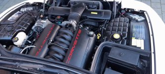

Picture of my engine... just because, well, engine ❤️😅
For over 20 yeas my 1999 C5 has used the NGK TR6, they are one step colder and gap is a bit shorter for a better idle
I know many others with C5 also using them

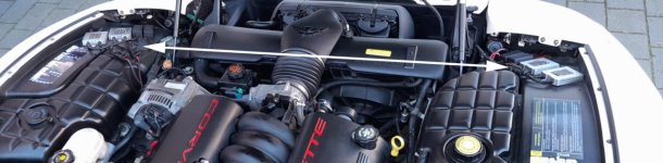

As to your engine bay :)
BTW, what are the electronic boxes on both sides, 3rd party lighting ?

Also, I won the car in a Japanese auction and it came with a lovely set of aftermarket light internals fitted.
The boxes you see are the ballasts for the xenon lights 😎🤙

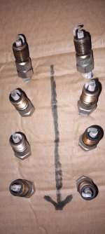

Finally got round to doing my spark plugs. Big thanks to teamzr1 for recommending the NGK IZTR5B11 Laser Iridiums. They're a perfect fit 👍
Someone could of warned me about how much of a pain in the a**e this plug is to change!
But it's done now so happy days 😅😂

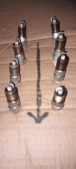

Here are the plugs I took out, in order of which cylinder they came out of (the arrow indicates the front of the motor).
Clearly a very healthy running motor, so I'm very very happy 😊
Thanks for all the help and input everyone ❤️
Did you measure the gap on the old plugs ?
Sure looks like they stretched as they look too wide or someone gapped them wrong
If your arrow was pointing to the front, then does it look like cyl #3 has a bit of oil on the threads as maybe a valve cover gasket leak ?

I did have 2 leaking valve covers around 12 months ago, I also had a leaking valley cover around 10 months ago... all of which has been sorted and I fitted a new PCV pipe system plus a new oil pressure switch as that went bad all at the same time 👌.
The new plugs I've put in are all gapped correctly to your above specification (1.1mm).
I honestly can't say how old the plugs that I've taken out have been in the motor... at least 2 years as I've never changed them since I had the car imported from Japan.
The car has gave me no running issues or misfires etc, in the time that I've owned it (apart from when 1 plug lead snapped in half! They were the original 20+ year old leads so expected! I fitted a full new set of silicone double thick leads earlier this year 👍).
Car runs as good as it did before I did the plugs 😎👍
Can't complain 😁😁😁
OK, that answers why there was some oil on the threads
The old plugs look like the gap was like 0.70 to 0.80 is way too much and yes 1.1mm or 0.43 is good gap
