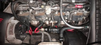

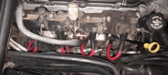

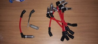

New plug wires came and they keep falling off the spark plugs. I'm not an idiot before you think I'm not pushing them on to the plug properly! I'm fitting them perfect, they click on as they should. As soon as I start and rev the car, a few of them randomly decide to keep popping off the plugs and I can't figure out why because they push back on and clip on again as they should???? 🤦‍♂️ 🤷‍♂️
Might be possible that there are C-clips on the end of plug wires as I show below are missing
Look and see if that is the case. Maybe they were in the shipping box ?
Could you take them off the old wires and put on new ones ?
Were the plug wires the same length and ends same size as old ones ?
Also, the end of sparkplugs have an end piece that screws onto the end and maybe those are not on the plugs ?
Look closely and see if those C clips are on as shown on left side, where right side clip is missing

I can't see any of them clips you have mentioned in both the old leads or the new leads...... 🧐 I refitted an old lead just to rule out me missing something obvious, but the old ones definitely clicked on with a stronger feel.
Anyway, I got up and to it in the dark at 7am this morning 🥱😴
The new leads are only slightly longer than the stock GM ones, but they're advertised as an upgrade from the standard 7mm wire to a 10mm wire which is why I bought them. They just need to be routed sympathetically so they don't touch anything hot obviously or in a way that they can be pulled etc.
I took each one off and with a spare spark plug with the same top cap, I tweaked them with a pair of pliers so that they now fit with a nice, solid click on to the plug. I then refitted them and routed the wires as mentioned above.
I'm happy with the fitment of the wires now... so its time to order a new battery as my current ACDELCO is definitely toast! The condition sight glass is completely Black which ACDELCO indicates it's at the end of its life.

Plug caps are a success!
Just had a 64 mile round trip along motorways, A roads, B roads and through 2 major towns which involved me being stuck in very slow moving and stationary traffic for quite a bit.
So I can tick that off the list of jobs

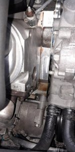

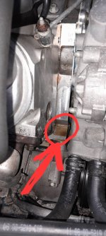

In regards to my oil leak, I have just got a picture.
So, the car was completely cleaned and free of any oil residue before I set off. Again, I've just done 64 miles and when I got home, the little pool of oil has appeared in the same place.
Again, I have tried to find where this is coming from but all surrounding areas are dry!
It's located behind the water pump on the right hand side of the motor.
I just get oil appearing on that square piece of the engine as you can see...
It hasn't ran down the motor, hasn't seeped from behind the exhaust manifold somewhere and like I said, all surrounding areas are dry from what I can see 🧐🧐🧐
Any ideas???

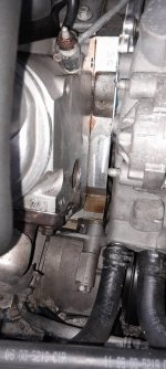

Any ideas???
or time for an engine dye kit on that issue 🤔 🤷‍♂️
You sound better as your post few days ago sounded like you were going to shoot your C5 :)
These wires are too fricking thick and harder for them to bend and not put stress on how they fit to coil and tip of spark plug
they also are too long
Being there are 8 coils, not just one and only few inches long there is no voltage loss from the coils and do not need bigger ones
as zero gains, and in fact could have more resistance than stock ones
In any case as long as engine is running with no misfires than leave them

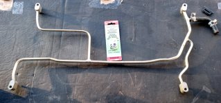

The bolt in your image is from the cross coolant lines, as I show for my 99 C5
They pull the hotter temps of the 4 outer cylinders via the heads
If that is where the leak is, that is a slight mix of coolant and oil in engine block
You might luck out and just need to torque that bolt down
If not, as I show, Doorman sells the gaskets that fit between block and bottom of that coolant connection
It does not look like oil stains, so looks like that coolant connection
You can buy some dye, first put in coolant and see if that is where leak is and if not
Then test with dye in the oil, that should then pinpoint where the leak is
As to noise, find a kid, have him ride in the hatch and have them locate where the sound is coming from,
else do as I mentioned in other post to track it down

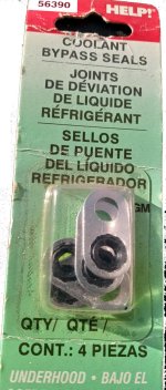

Here is a better image of the seals used at each coolant bypass connections, If I recall I go them for Doorman, maybe sold at rockauto
or maybe someone local to you sells them
As you see, part # is 56390
But to replace them the intake manifold has to come off, I do like in 30 minutes
Again I am not certain that is where the leak is, maybe if you can smell that area or wipe that down
and then smell rag and tell if oil or coolant
Or maybe for a short fix is put a sealer around it and see if that helps pinpoint as that being the leak ?

Cannot see any oil leaking there as to that photo
Maybe get some degreaser and spray that side, so it is nice and clean or use a higher pressure car washer
Then add the dye (auto parts stores should have it for engine oil)
Do a testrun and then most dye kits come with a special light or yellow glasses determine where it is leaking
before waiting and oil runs down, making it harder to see where leak started

Just that patch... right there.
That is oil you can see on that bit of the engine.
I can honestly wipe that surface as clean as the face above it with ease.
I can run the engine all day on my driveway and it will stay perfectly clean.
As soon as I go for a drive, that pool of oil returns every single time in that exact same spot! This picture was taken today after my 64 mile round trip... but it will still present itself in as little as a 20 mile round trip.
Again, I can't trace it because everything around it seems to be completely dry and I can't find anything suspicious with the use of my inspection camera either.
It's really puzzling me 😵
Then suspect the head gasket
Could pull that valve cover and try tightening the head bolts
They are torque to yield bolts so once stretched using a torque wrench is useless but could tighten more and see if enough
Maybe exhaust manifold gasket, being leak is so small just at idle not allow of exhaust flow, but driving would increase the pressure flow and then leak
There are products for engine oil to stop leaks that work fine and maybe cheap fix
That lower head corner to block and exhaust looks like exhaust carbon'ed up that corner and maybe bit of oil in exhaust
How's the sparkplug color for # 2 cylinder ?
