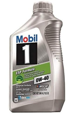

I've owned my C7 nearly 10 years. The concept of "topping up" is not one that I recognise.
I fill with Mobil 1 5w-30. Somewhat bizarrely it comes in several different flavours and at different prices. I'm using "ESP" which appears to tick the box for GM Dexos 2.
I've been using Mobil 1 for an alarming 40 years and must surely own the company by now. It's mighty expensive oil in UK. But, hey, I've never yet had an engine problem so perhaps I shouldn't be complaining....

According to this, Mobil now recommend 0W-40 for the C7/LT1 engine. Thats what the "lads" in Notts are using on their C7s and Camaros.
They've also fitted Catch Cans to them too:
Stingray
Quote: "What is Super Car Oil? Mobil 1 rebranded the 0W-40 oil to Super Car Oil in 2021, molecule wise the oil is no different."
Sounds like the same stuff I was putting in my Lotus Esprit 40 years ago, albeit now with a "so much sexier" name!! Without doubt there have been developments of the formula through the decades.
Back in the day (my first Vette - a C5, 1999) 5w-30 wasn't available in UK and 0w-40 was the right Mobil 1 to substitute.
IMO the great thing about modern synthetics is they're all so good it doesn't matter very much which one you use. Climate in UK never gets seriously cold and at the hot end there's considerable overlap between 30s, 40s etc. I'm an old-fashioned guy and tend to follow the manufacturer recommendations where possible. Some modern cars have incredibly narrow oilways compared with back in the day when Duckhams 20-50 was the gluey gunk of choice. Most cars in a scrapyard today have an engine that works but have been written off by another, expensive mechanical/electronic disaster. Auto transmission hiccup? Airbag problem? ABS failure?
