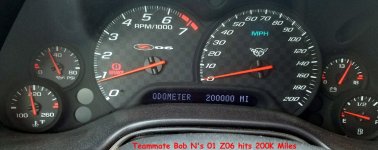

Here is a 2001 Z06 that did lots of racing and hit the 200,000 miles and no internal engine work
