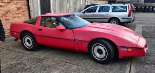

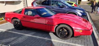

Absolutely fine to use a machine polisher on a Corvette. Two pictures of before and after polishing.
This was very faded and almost pink looking.
This was done with a cheap rotary polisher and Farecla G3 compound followed by a coat of Meguiars Ultimate polish.
I have since bought a good DA polisher and some polishing compounds so it will be further refined and given a coat of Soft 99 Fuso wax
