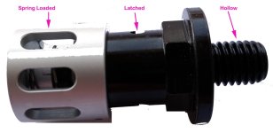

FYI,
If ever wanting a drain that never needs to be taken in or out, I have used these
The bolt end is hollow
the drain side is spring-loaded to prevent it from popping open, plus it has a latch where the drain side is pushed inward
and then turn it to the latch stop
With the spring-loaded against the latch it will not pop open and wanting to drain push drain side inward, turn and let
go and drain opens to flow
