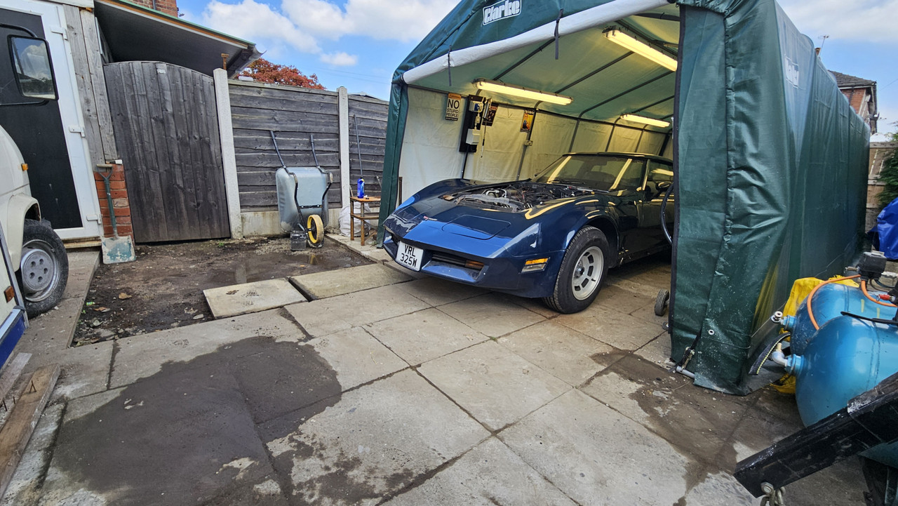

That looks like a real struggle taking the engine out from the side. I had the use of a long arm crane and even that only just reaches with mm away from the nose. Block and tackle from an RSJ or gantry is probably the way.
I did once remove my big block engine with a short reach crane from the side......but only with drivers side front wheel removed to get crane feet in the right position.
