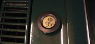

I live in an area once the centre of a thriving Cotswold wool industry where old water driven Mills abound and although now defunct the water courses that provided the power are still active. Our house and six others are effectively situated on an island formed by a Mill run and its overspill dividing upstream and reuniting again just downstream. This means that after periods of heavy rain we can get flooded as the streams swell but also at this time of year the relative humidity is at saturation level. This was the reading on the bonnet of my C3 this morning, typical of this time of year...

95% cripes! Can be done though with air movement. A few years ago we designed a new hotel swimming pool air handling unit that dehumidified solely via air changes. Typically they will have a cooling circuit, heating circuit and electronic dampers regulating fresh air input and moist air extract but this one we did without a cooling circuit as there was no where to site external condensing units nor could we incorporate an integral cooling circuit due to excessive noise mitigation issues. Works just fine for this large internal swimming pool and all the moisture it produces.
